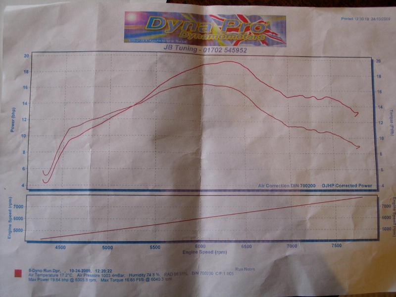

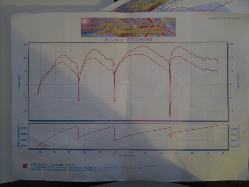

hi all this is my jb built RT220 , race tour 60mm crank, 35mm mikuni carb,19 - 46 on indian GP200 gear box
dev tour exhaust,barrel and manifold all matched and flowed,rides really great pull like a train,fuel consumption
seems to very good as well maxs are 19.64 bhp 16.65ft/lb
cheers poppygun
3rd gear run
3rd gear run
