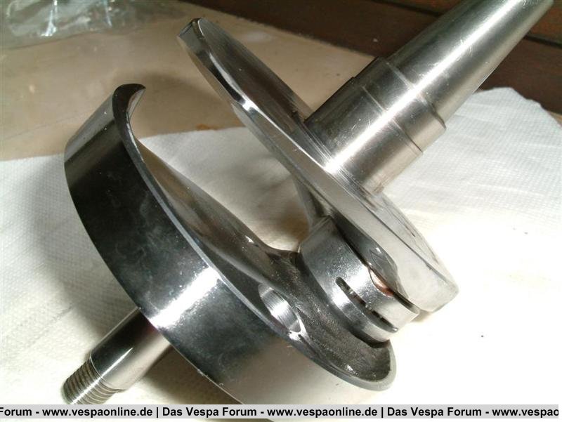

I'm going to be changing my rotary 210 to a 60mm crank soon. I'm toying with the idea of doing the "Kabawelle" or "Flexkiller" web mods as the Germans seem to be getting good power boosts from them.
Very extreme version on a 62mm crank:
lol,i,ve been cutting vast amounts of metal away on reed valve cranks for years
