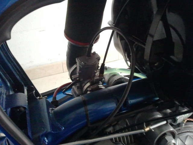

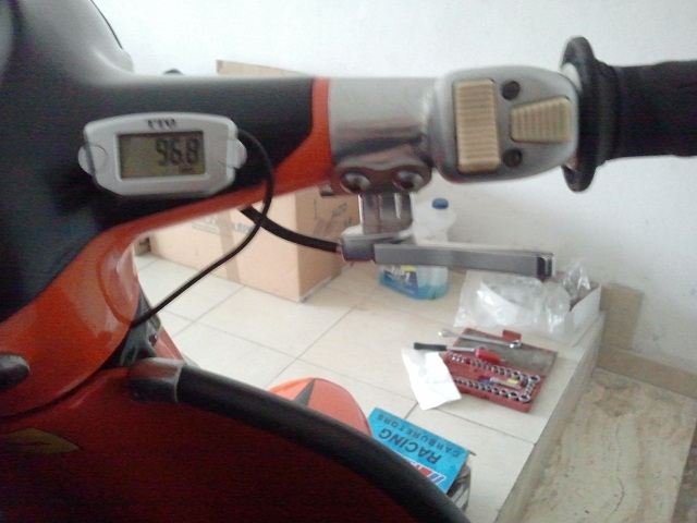

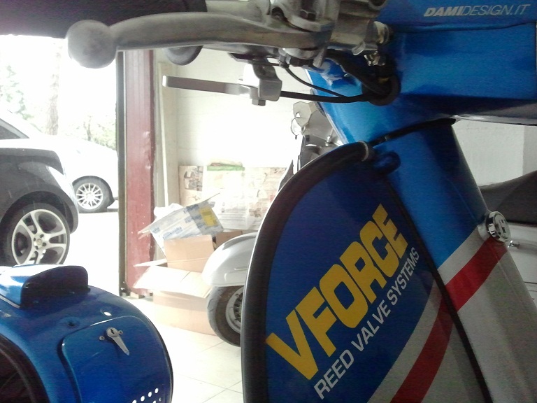

Some pics of the choke kit fitted to my Lambrettas:
