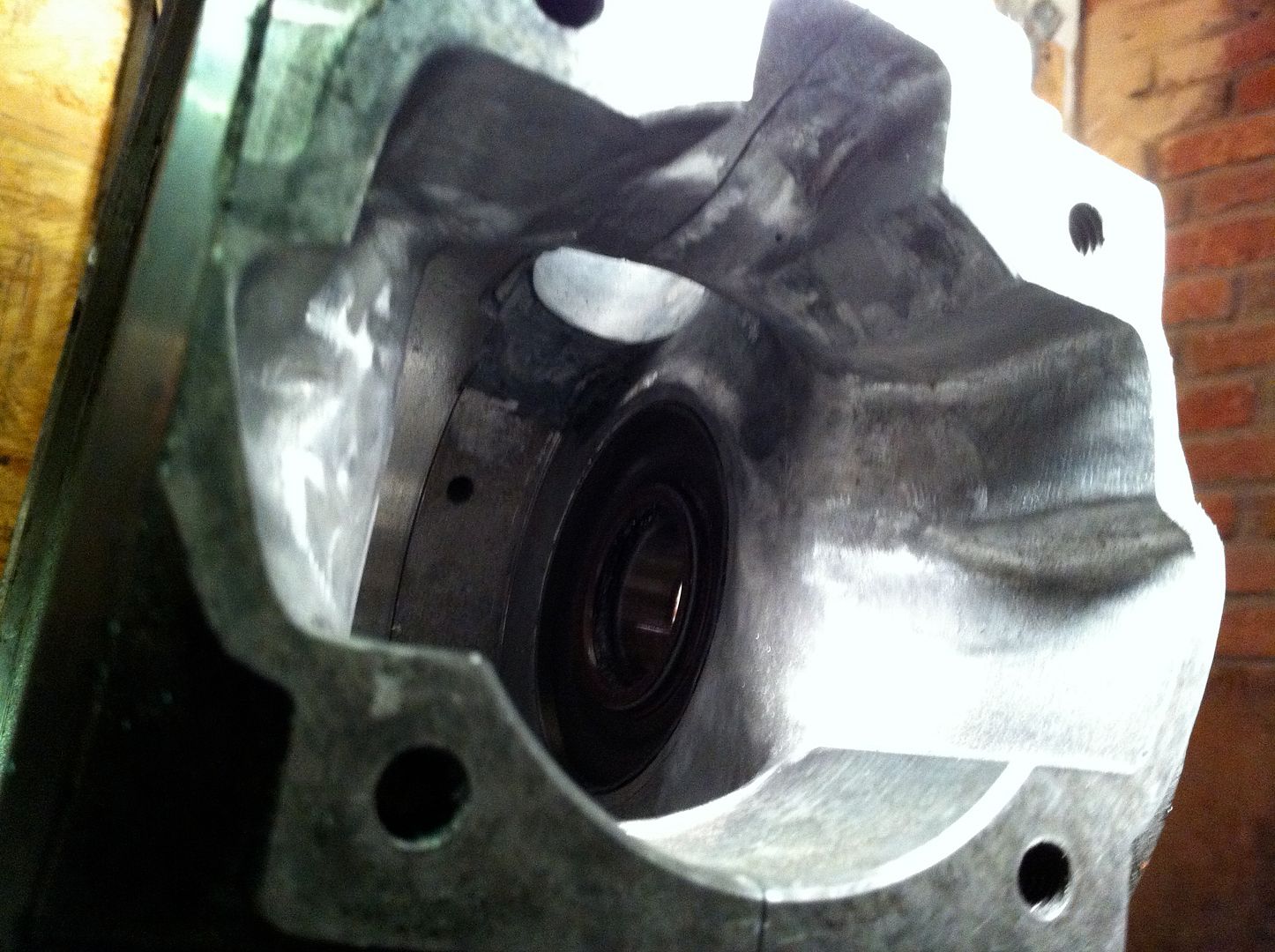

ok lads im looking at porting and then matching the cases can anybody put some pics up of the best porting areas and how much to take out cheers

could be like this:

Your a maniac frog. Leave some metal on the casing
fastfrog
Posts: 412
Location: Paris, Taxes
I'll do better next time!!

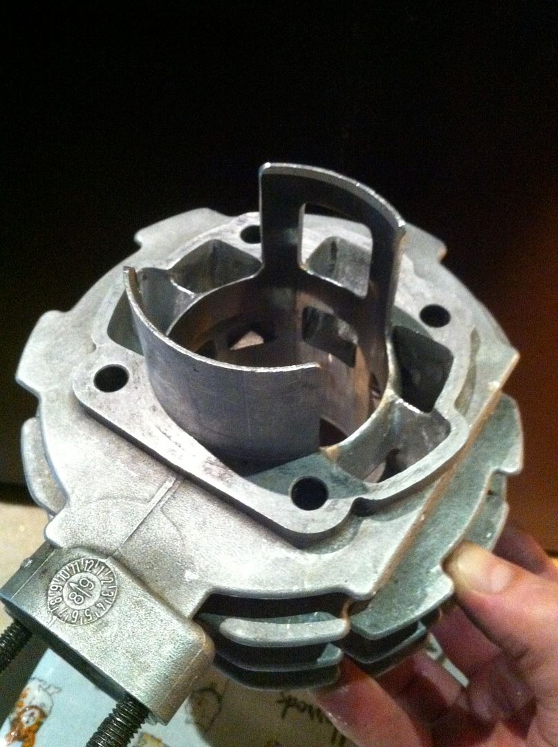

I find the easiest way is to cut the base gasket to the cylinder then use that to mark the casings with a sharpie
