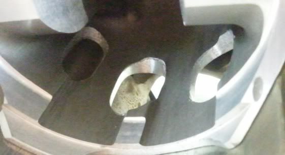

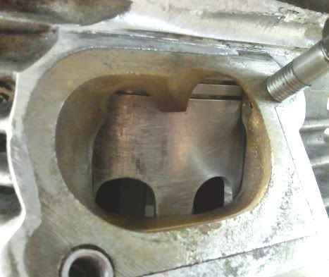

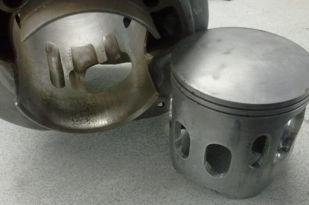

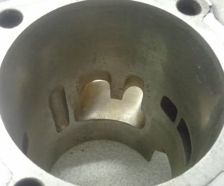

Customer brought a Rapido 250 cylinder into Sean to see if it can be made good and tuned up.......and an MB reedblock conversion done ,ever eager to help out, Sean talked it through with the chap and they settled on a triple boost port option, a few new holes in the piston, a reed-valve conversion (obviously), and a little tickle to the exhaust port (widened and raised 2mm ).....here's what Sean had started doing when i turned up, its had more work since but i had to go, so these are the pics i got (below). It'll then need a light hone, new rings and a bit of tidying up......but should be a good tune when finished.

has it broken through the cast liner to the alloy where you cut the slots; would that effect it,
muppet
C’est la vie
no it hasnt actually and even if it had it would not affect it
porting costs and modifications in this particular case amount to approx £150..but the engine was already out of the frame ...that accounts for all the barrel ports ,piston mods and exhaust port mods also matching ex to stub and inlet to reed block ..(removing all the fins etc to make the MB block fit etc ).
